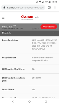

When I first looked at 90D specifications in Canon India website, I couldn't believe Canon has provided IBIS for 90D.
After looking at US site and 90D manual and no mention of IBIS anywhere else, seems to be just incorrect information on Indian website.
  • Wow
Reactions: pj1974
It could be a mix-up with the video stabilization.....
