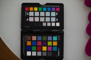

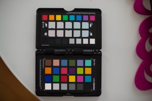

The old 1DX LCD white balance representation was off but this one is waaaaaay different. Skin tones look bluer and duller than they really are. I tried shooting in Auto WB or even Flash or anything and I can't really see which one is more accurate.
I have the same problem. LCD are very color different - 1DX2 is too warm/yellow apart from 1DX.
The worse is that even output from 1DX and 1dX II is different - even x-rite passport profiles are not helping.
