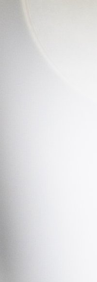

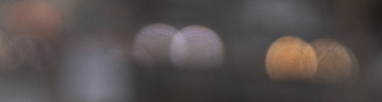

I noticed that I keep getting these strange horizontal lines across the highlight areas of my images.
Has anyone else experienced this with their R cameras? I'm wondering if it's a sensor issue, or if it's a normal phenomenon.
Granted, this is an 8x crop that I'm showing to illustrate the issue. However, my 1DX2 and 5DsR do not produce lines like this at any crop.
I still have a week to return the camera to the Store for a replacement, so I want to make sure everything is operating as it should.

Could you share some details of the conditions these shots were made under? Like, lens used, JPEG or RAW, if so, which RAW converter and what editing steps? Are you using CRAW? Silent shutter maybe?
I've not seen something like this, it looks like some artifact and not normal. But I haven't handled any RF camera, so Iv/ just curious here.

Hi Joules,
Those are from full sized RAW images at base (100) ISO. I'm using the latest version of Lightroom Classic CC, and the lines appear on the unedited RAWs. Also, I was using the mechanical shutter. The lens was the RF 85mm f/1.2L.
I borrowed an R from CPS on two prior occasions -- once back in May and again in September. Looking back at my photos from the loaner units, they too show the same pattern -- horizontal and vertical lines.
It's always in the bright highlight areas, and usually where the highlights transition to a midtone. The lens that I predominately used with the loaner cameras was the EF 85mm f/1.2L II.
I've not found any photos so far where the issue presents itself while using an f/2.8 lens or slower. The phenomenon is definitely there with both the RF and EF 85mm versions, however, on both my camera and the two loaners.

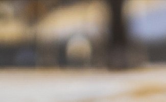

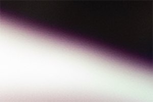

Also, I've noticed a very digital-look checkered-artifacting in some images.

Here's a RAW image I have available:
The bokeh balls in the background and the snow near my dog show the horizontal lines.

UPDATE:
The Camera Store finally got a replacement camera in for me.
Unfortunately, the new camera is doing exactly the something. I'm getting the same strange lines/patterns shooting wide opening with the effect diminishing around f/1.8 using the RF 85mm f/1.2L lens.
I'm attaching another screen captured zoom in, as well as linking to a new RAW file from the new camera.
Also, I can see these same lines from the camera generated JPEG preview on the back of the camera screen or through the EVF.
