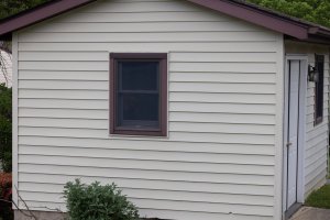

I have tried to reproduce this fault with my R5, but I am unable to do so. If I understand the (sometimes garbled) problem, the first photo after power-on or wake-up might be blurred. I tried an RF 24-240, an RF 35mm macro, and an EF 24-105 lens, and in no case did I experience a blurred first shot. Here is just one example, my garden shed, first shot after turning the camera on. RF 24-240mm @90mm ƒ9. Electronic shutter. This is the full frame, but CR would not accept the full-resolution photo (8192 x 5464) so I reduced it to 5000 x 3335. Conditions: heavy overcast. No user processing.

I have tried to reproduce this fault with my R5, but I am unable to do so. If I understand the (sometimes garbled) problem, the first photo after power-on or wake-up might be blurred. I tried an RF 24-240, an RF 35mm macro, and an EF 25-105 lens, and in no case did I experience a blurred first shot. Here is just one example, my garden shed, first shot after turning the camera on. RF 24-240mm @90mm ƒ9. Electronic shutter. This is the full frame, but CR would not accept the full-resolution photo (8192 x 5464) so I reduced it to 5000 x 3335. Conditions: heavy overcast. No user processing.
The issue appears on Non-IS Lenses. All the lenses you listed are IS, so it would make sense you are not seeing it.
I can see a definite difference between shots at slower shutter speeds, when I compared sharpness between shots at 1/125th of a second or shower at 24mm vs shots at 1/250th there is a definite difference, with the faster shots being noticeably sharper, so there is a definite issue. Doesn't matter if lens stabilisation is off or on, results are the same.
