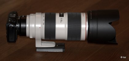

Dylan777 said:
lw said:
Dylan777 said:
The MOST important factor for Canon to gain ground in mirrorless world is EF adapter to mirrorless. If they can come up with adapter with decent AF speed, better than current ones on the market, I think that will give Sony, Fuji etc... good run.
Enlighten me on why they need an (EF adaptor to mirrorless) "adaptor to mirrorless with decent AF speed"?
In what way does the current EF-EOS M Mount Adaptor affect "AF speed"? And how would you improve it?
Or are you talking about some other adaptor?
For Canon shooters, standard EF and L lenses are as good as gold. These lenses can still be used with EOS-M system with an adaptor, however, AF speed becomes slower.
The adaptor doesn't make AF slower though does it?
It is the EOS M body that has slower AF. All the adaptor does is pass through the signals, doesn't it? It is just electrical contacts.
I can already put my EF and EF-S lenses on my EOS M. I don't need a new adaptor for that.
What I need is a new EOS M AF system that focuses them quicker.
I will repeat, in what way does the current EF-EOS M Mount Adaptor affect "AF speed"? (I am actually interested to know, as I am not aware of it. Not keen on having to buy another adaptor as well as a new M!)

Dylan777 said:
I've tried 70-200 f2.8 IS II + adapter on eos-m Vs native 22mm. AF speed is not the same. Why? I can't tell you.
Neuro confirmed his adapter + L lenses is faster then native 22mm. Maybe, other members can give their feedbacks.
Hardly a valid comparison though as it is two different lenses. It doesn't demonstrate that the adaptor makes a difference....
The fastest focusing lens I have used by far on my M is the EF-S 55-250mm IS STM - via the adaptor - it is faster focusing than any native EF-M lens hence demonstrating the adaptor has no impact I can see. My belief is because it is able to house a bigger STM motor than the EF-M lenses, and the M is optimised for STM lenses. It is faster than my EF 70-200 f2.8 IS II. Nothing to do with the adaptor AFAICS.
So, I can't see any reason that a new adaptor is needed for the M

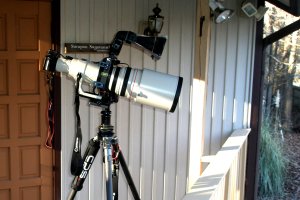

lw said:
Dylan777 said:
lw said:
Dear Friend Mr. lw.
My EF-EOS M Lens adaptor By Canon never slow AF speed for all of my 19 Canon EF- Lenses, and Tamron + Sigma Lenses----Electrical connection are super fast, not matter 2 inches distant or 10 feet distant. Yes, That are my Observation since I have EOS-M more than 1.5 years ago.
Yes, I will buy EOS-M III, And EOS 50+ MP. when they on the Market.
Have a great work Week.
Surapon
