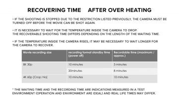

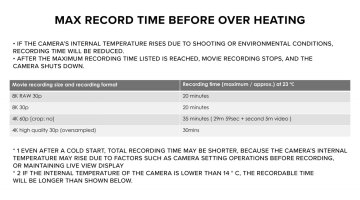

This information was supplied by Canon to the largest UK pro-video dealership CVP. It comes directly from the manufacturer’s own testing results. The Canon EOS R5 does push the technology under the hood very hard. With only passive cooling and no fan, in a body barely any larger than the Sony A7...
www.eoshd.com
Where were these images taken from? it looks like they could be from the manual?
