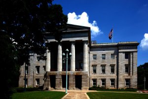

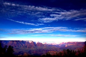

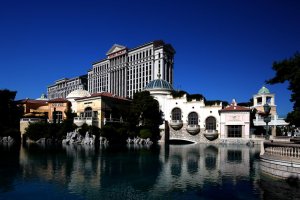

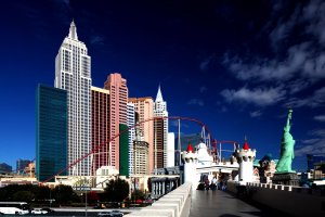

Dear Friend wade.
Yes, Every products in this world ---Start from the Design, and end of MFG. = Only perfected Products = 99%, and hope that ( From the MFG.'s Point ) only 1% defected product--Or Less than 1% of over all.
Yes, You may the lucky person who win the Lottos.
Sorry to hear that you might get the Lemon of This Awesome TS-E 24 mm MK II, BUT, I get the Good one 6-7 months ago, with no problem at all.
Good luck
Surapon
