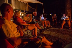

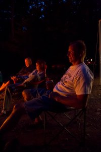

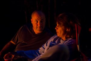

I didn't read through this whole thread but there is no way I'd capture images like this back in the film days. They don't mean anything to anyone but me and my friends but without high ISO they aren't happening when lit by firelight.
