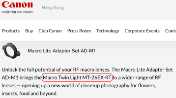

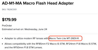

There's an error in the description of the kit, which refers to a, "Macro Twin Lite MT-26EX-R"...unless Canon is making a new twin flash that they didn't bother announcing, there's a 'T' missing and the flash in question is the Macro Twin Lite MT-26EX-RT. This is not a typo on the part of CR, it's Canon's fault. The Canon USA page is wrong (and B&H, et al., mimic the error).
Canon HK gets it right, though:

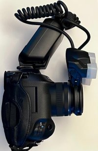

Out of curiosity, I tested that approach with my RF 24/1.8, a 52-58mm step-up ring, a Canon Macrolite 58 adapter (which I use on my MP-E 65), and the MT24-EX flash. Though the lens itself gets a little lost among all the other gear, the setup appears to physically work.
It turns out the problem, and thus the need for the new adapter kit, is that the RF 24/1.8's extending focusing mechanism can't handle the weight of the twin-lite setup. When performing autofocus (or even when turning on the camera on), with the twin heads mounted if the lens is held at an angle, the camera gives an Error 60 (problem with lens movement).
