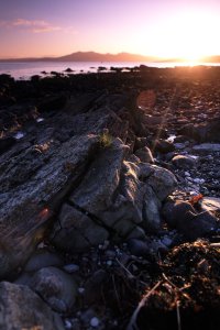

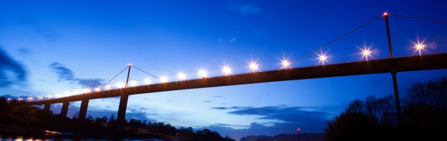

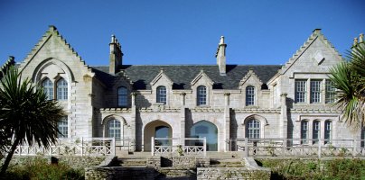

and guys, as I'm looking for a new lens, can you please shortly describe (with photos as well) what you need TS lenses for? I can afford any of them, but I'm worried if I will ever use one...
I used mine (24 TS-E) for the usual converging vertical corrections (In the slipway shot I wanted to keep the camera back level so as to keep the bridge pillar and the reflection straight, the shift let me do this but also move the frame to the interesting area)..
but also parallax free panoramic stitching using the shift movement along a horizontal plane.. on both these shots (Garrison House cumbrae, and Erskine Bridge pano) a wider angle lens could have been used, but it would have affected the image resolution, by shifting and stitching I was able to generate a much higher resolution image without parallax issues, as the camera back was always in the same position.
And finally I used it for the selective depth of field trick. I could have used the tilt the other way to increase the depth of field, prefered this way to focus on a specific area, this let me focus on the same plane as the sloping rock in the foreground, where as a conventional lens would have only given me a slice of focus this close to the camera.
