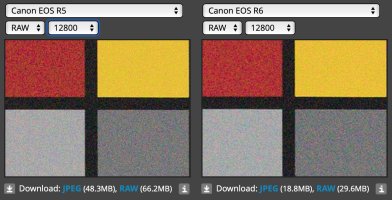

The screenshot I took best illustrates this.
You're magnifying the higher resolution images more. If you normalize the size, in either direction up or down, then the higher resolution sensors are actually a bit cleaner in the comparison you chose.
You may counter that the AI processing could be working on the full image. But I highly, highly doubt that and you said the same. I won't say with certainty that they are not without a reference, but I cannot imagine that they are. The R5 overheats shooting 8k RAW and AI analysis is going to be roughly as intensive as anything involved in writing RAW video, if not more so. So how could it possibly analyze 45mp frames at a minimum of 20 Hz (would likely have to be much higher) continuously without overheating?
Everyone is probably line skipping sensor readouts at 12-bits or less for the AF processing and EVF display.
I do know that lower megapixel sensors perform better in lowlight when it comes to noise because of the pixel size.
They do not except at the very highest ISOs. Not even at 51,200 as illustrated here. You can't use different view sizes and claim that lower MP sensors perform better in low light. That's like comparing a 20x30 Velvia 50 print to a 4x6 Delta 3200 print and declaring that higher ISO films have less grain.

You can try this comparison with any number of cameras made over the past 10 years. If both the format and the view size are the same and the tech level is comparable, then higher pixel density does not result in visibly worse noise except at the most extreme (and unusable) ISOs. This is actually what you would expect given gapless microlenses and the relative strengths of shot noise and e-noise in a modern sensor.
If you do that comparison, you will not see a lot of difference between a new camera and a ten year old one. You will see a big difference if you download the RAWs and then overexpose them by five stops. Then the bottles look very different. Even at ISO 100 you will see a lot of noise on ten year old cameras. That will be the first test I will do once the R3 RAWs are available.
Agreed, but I'm talking about high ISO performance, not base ISO dynamic range. Since you bring it up though, DR is another area where people assume pixel size matters and it hasn't for quite some time. The highest scoring 35mm sensors on DR right now are also the highest density sensors.
Edit: Also, I didn't mean to imply that a current camera would show no high ISO advantage against one from 10 years ago. That's why 'comparable tech' level was one of the stated conditions. I meant to say that pixel density has not mattered much for at least the past decade. If you go further back, before gapless microlenses, then pixel density did have a significant impact on high ISO noise at the same view size. High pixel densities meant more chip space spent on circuitry and without gapless microlenses, lost photons.
And this explains your disagreement with Mike. He's looking at individual pixels, you are looking at on a per-area basis.
He's right when talking per pixel, you're right when talking about the overall picture. Thus you'll never convince him he's wrong (and vice versa), until and unless you both get on the same page.
There's no reason to look at individual pixels unless the argument is that the AI AF looks at pixels in a way that makes per pixel noise matter. I don't see how/why that would be the case. Even the general assertion that image noise would present a difficulty to an AI is up for debate. I would think AI-based systems would be quite good at ignoring regular image noise so long as that was part of the initial training.
I tend to agree, but a lot of people don't, they pixel-peep and that colors their evaluation of everything. I get to watch this particular wrangle here again and again, each side talking past the other because they don't realize the other person is/is not pixel peeping.
