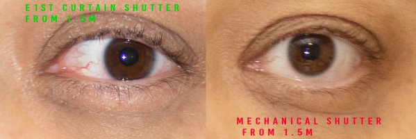

I recently upgrade to R5 from 5dM3 and so disappointed. After couple of shots I found that MS give a significant shutter shock as a portrait photographer it is so important to me. I returned my camera and requested for replacement, and while I was search to find the root cause I found this discussion thanks to Rzrsharp that old this.
I had no clue if my R5 is faulty as everyone in R5 FB group said they don't have any problem with MS.
So it means all of the R5 are faulty, yeah I can use EFCS but the quality of the bokeh will be affected.
I was wondering how some of the people here said there is no problem with it . I just moved from 5d M3, not only shutter shock is obvious it is in an unacceptable level.
I sent a complaint email to canon, and I believe if everyone raise an email to them they will take it to account.

What were your shutter speeds? The first shot has a much higher component of flash in it.
