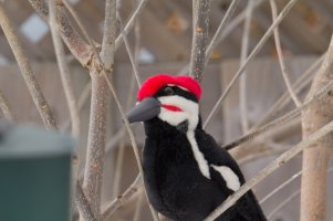

As promised, I took an SX-50 and a 60D with a Tamron 150-600 outside to see how they stacked up against each other for bird photography.
The goal is to place a blue-jay sized object about 40 feet away and to see how much detail the various lenses can resolve.
The last time I tried this was with the SX-50, a 70-200F4IS, and a Sigma 120-400.... on that test the SX-50 won, the 70-200F4IS came in second, and the Sigma 120-400 was a distant third.
Here are the reduced size originals... SX-50, Tamron 150-600, and Tamron 150-600 and 1.4X teleconverter.

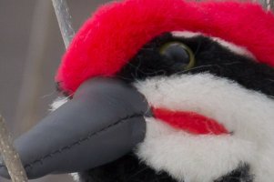

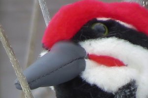

Here is what an 800 pixel wide crop from each image looks like... SX-50, Tamron 150-600, and Tamron 150-600 and 1.4X teleconverter.

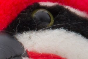

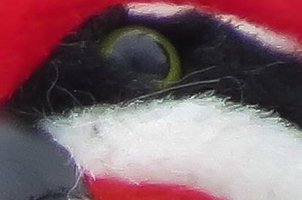

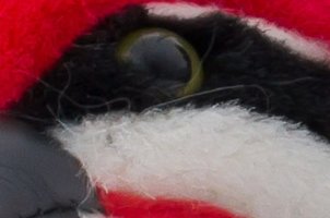

Here is what the same scene from each image looks like when enlarged to the same size.... SX-50, Tamron 150-600, and Tamron 150-600 and 1.4X teleconverter.
In this case, it seems like the Tamron with the teleconverter resolves the most detail, the bare Tamron is second, and the SX-50 comes in last.... but when you consider I paid $300 for the SX-50 on sale and it fits into a coat pocket, it is a surprisingly good performance for such a camera.
Thank you for testing. The Tamron + teleconverter is very impressive. Yes, I have to admit that modest SX50 does a good job, and is unrivaled in convenience.
