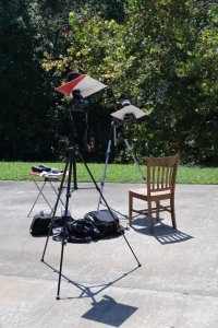

For the 2017 total solar eclipse, I was shooting with my T3i. My only telephoto lens at the time was the rather bad 75-300mm that has a lot of chromatic aberration, among other faults. I was concerned about diffraction, but also needed focusing leeway from depth of field, since I didn't dare look through the OVF, and focusing on the screen, even shaded was rather difficult. I also presumed that stopping down would help minimize the CA. Graphs I saw on line suggested that f/11 was the best choice at 300mm on that lens. Days before, I put the filter on the lens and practiced shooting the sun. Even keeping the sun in the picture was a challenge, even through I had swung the floppy screen into the shadow of the camera itself. It turned out that f/11 gave sharp looking pictures with that less than optimal lens. Sunspots showed up very clearly. My eclipse pictures turned out about as well as those by people using superior equipment.
Here's how I dealt with seeing the non-flippy screen on my cameras during the eclipse: foam board with holes cut just the right size to slide them onto the lens (from the rear before attaching it to the camera).
184022
I'll think about that if I head to Dallas in 2024, I think it is. There will probably be fun stuff going on on the SMU campus, where I went to grad school.
As it was, even with the flippy screen shaded by the camera, it was hard to see. I sent the friend I had come with back to the car to get a black umbrella. He eventually got back, after chatting with a radio crew and a woman who had come from France. And I could see decently well as long as he was patient enough to hold the umbrella. My first few pictures were not usable. I posted some of them and an assembled video at http://www.stevelee.name/eclipse/index.html
If I had not practiced on the sun a few days before, I could not have done much during the eclipse. I had to deal with the realization that to photograph the sun, one has to be out in bright sunlight. The flippy screen helped, but moving the camera to keep the sun in view was harder, because the direction of movement was uncoordinated with how it appeared on the angled screen.
