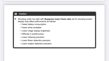

The issue is becoming more wide spread now, I see new people and posts and threads every day with people experiencing the same thing. And mine got worse again after being okay. I’m going to try to turn off the “suppress slow frame rate” function and see if anything changes. Hopefully more people will contact Canon about this. It’s beyond frustrating and I couldn’t get the rollback to 1.4.0 to work…
Have you had ‘Suppress Slow Fram Rate’ enables this whole time? The R5 advanced user guide says suppress slower frame rate may cause “Difficulty in Autofocusing”. (Pg. 277)
Thanks for sharing that, I had it enabled yes, I tried today turning it off, but didn’t see any difference, but I’ll definitely keep it off now. Thanks.
This is an EXCELLENT reminder. It's just too new for me to automatically be turning it off and on as needed. I think default off works for me, because I'm not in the low-light situations nearly as often as in brighter light. My studio space is usually lit enough to avoid the jerkiness. Thanks!

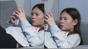

Here's an example of one of the AF issues. Both shots confirmed and locked on the eye, but in the oof one I saw in the EVF it wasn't in focus. I kept holding the Af button down in Servo to have it continue to try and lock, it kept the same oof when I moved the camera back forth trying to get it to lock. When checking AF point placement in playback it showed the small red square one the eye for both shots.

It definitely looks like the camera tried to focus on the phone, not on the eye.
Have you tried saving the settings onto the card and then resetting the camera?
Yes, it looks that way now that you see the focus is in another spot, but according to the AF system and review it is focused in the exact same spot both times. And it's not just a focusing miss, sometimes it feels like you have set the camera to the fastest respons in the Case settings and sometimes it feels like your looking through the EVF without pushing the focusing button. Both tracking and detecting are seriously lacking with 1.5.0 ehere it really didn't with the 1.4.0.
can't confirm 100% but I did turn that setting on post firmware upgrade and about same time noticed the erratic focusing issues.. turned off and recent attempts seem to hold / follow focus back to normal... weird.
