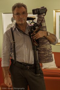

I am using a monopod and a flag bandoleer (used to be a boy scout) when I handhold and that is a brilliant solution. It takes away all weight (and tremble) issues. I´ll post images of this setup when I get the time to shoot some.

Jackson_Bill said:
So you tie (or clip, maybe?) the monopod off to a strap you wear across your chest? That sounds like a really slick idea - I'll look forward to your post of the setup.
Manfrotto makes a monopod belt pouch - at first glance, you might wonder how it holds the monopod while you walk…then you realize, it's not intended to hold the monopod while not in use (incidentally, I use a Maxpedition universal flashlight/baton sheath for that), it's a pocket for the base/foot of the retracted monopod to rest in, while you're actually shooting with the camera+lens supported by the belt.
Here are a couple of images with the 1DX and the 600 f4L IS II.
Just get in touch with a flag producer. They should have it. An easier option would be to just have the cup on your belt. But I believe I get better weight distribution with the shoulder straps. I can walk around with this for a long time without having any trouble. To shoot overhead I only have to adjust the monopod. The RRS tilt head is essential though.
I have experimented with straps from the lens to the shoulder straps, to keep it stable while I operate a second body, but that has not been really successful yet.
