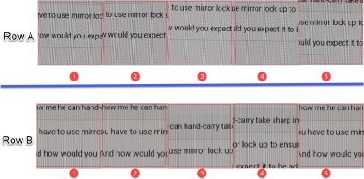

Below is the comparison between two group Row A and Row B. Each row is 5 photos in sequence (no picky).
One of the two rows the photos are mechanical shutter, another one is EFCS. All shot at F2.8@1/100s, IBIS On. Screen capture from DPP4 quick view at 100%.
No any further processing (sharpening or NR).
I do think you guys can easily tell the diffenrece when you zoom it to 100%.Mech vs EFCS - 10b.jpg

1)Gender story tell you average men are taller than women. But when you mix up the data, there have no meaning, you cannot tell the gender alone. Mix up the photos are same.
2)However you hold the camera, mechanical shutter of R5 will generate shutter shock at 1/100 (expands to 1/50-1/200 at least). And average, EFCS get higher ratio of sharp, even not 100%.
