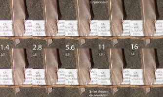

With all this talk about diffraction, I decided to have a little play with it myself.
I set up my 24 MP 80D with the sharpest lens I own, the Sigma 35mm 1.4. Put it on a tripod in the garden and shot some newspaper text behind a small bird feather in full sunlight. Attached is a compilation of the results. The upper row is made up of unprocessed (just whitebalance) crops from the center of the frame with all apertures I'd consider interesting. Below each is the same crop, deconvoluted in Photoshop CC using smart sharpen with the radius written below the aperture values. The radius where set by eye, looking at the contrast of the i in the "mit" to the right of the feather. I increased it, until tiny halos became visible, and dialed it back again slightly, to get it natural. Using some more advanced method for deconvolution may yield nicer results, but for now I get along with smart sharpen best.
Seeing as these are really hefty crops (about 350px wide each, from the 6000px full width), I'd say all the processed crops would pass as sharp at less magnification. At this magnification, you can start to see detail getting lost due to diffraction in the tip of the feather at f/11. And at f/16 it's quite noticable - but it's not really blurry. And thanks to the larger depth of field, it may actually look sharper over all, if the subject included any depth (This is just laying on the ground). It just lacks the finest of detail. And as for the 2.8 and 5.6 image - with more pixels you could pull out even more detail from those.
Also, I think with 32.5 MP, the pixel density is enough that even Canon won't hesitate to eliminate the AA filter, making the images all a bit more detailed yet again.
I think it may not be necessary for the most cases to go above 24 MP, but it certainly doesn't seem useless to me. And diffraction is not a thing that causes any image at higher apertures to become automatically useless or blury.
