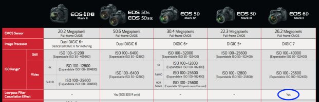

So I found this chart which compares Canon's full-frame cameras:
https://prophotoblog.ca/wp-content/uploads/2017/06/Canon-EOS-Full-Frame-Comparison-Chart.pdf
It looks official enough, although the link to the same PDF on the Canon site doesn't work for some reason so I can't be sure.
Anyway, the fourth row of the specs chart is "Low pass filter cancellation effect" and for the 5DS/5DS-R it says "Yes (for 5DS R only)" as expected. But under the 6D II it says "Yes" as well. I found this unexpected - has anyone else commented on this? I haven't read all the discussions, or the manual, so perhaps I'm just out of the loop. If this is indeed correct it might change the math a bit on the value of upgrading to the 6DII, particularly for landscape shooters.
Interesting catch. If 6D II is indeed with either very weak AA or completely AA-less, that would be very beneficial for many people. Then again not very beneficial for videofolk, but since 4K party is already shopping for torches and pitchforks...
What is rather weird is that Canon did not emphasize any AA-less features in any of the marketing materials. One would think they will try to exploit such feature to appeal a certain niche of potential customers.
Maybe the 6DII applies sharpening algorithms in camera to compensate for diffraction and the AA filter. If so, this would be in camera post processing rather than something to improve the image at capture, like the cancellation layer that the 5Dsr has. In camera post processing would seem to be relevant to out of the camera jpg files, and possibly video, but most likely would not affect Raw files. If so, it doesn't strike me as all that big a deal, which would be consistent with Canon's low key treatment of this feature.

neuroanatomist said:
Interesting. However, Canon's tech-mouthpiece, Rudy Winston, states that the 6DII has an AA filter.
[quote author=Rudy Winston / Canon DLC]
Diffraction Correction is built-in (can be turned on or off, on camera’s menu). Added sharpening applied to counter both the effects of lens softening at small apertures which are common in landscape shooting (f/16, f/22, etc.), as well as providing specific sharpening to counter the softening effect of the low-pass filter immediately in front of the EOS 6D Mark II’s image sensor (when shooting at wider apertures).
That's backed up by the 6DII manual in a couple of places.
[/quote]
But I guess none of this corrections will apply, when shooting RAW, right?
Spotted what you were referring to (attached). As it's not anywhere in a 610 page manual, I'm guessing that chart has a typo, but I could be wrong.
