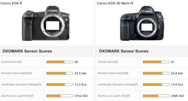

No point in throwing charts at you? You told me to check the DxO charts on the 5DIV and the R as they showed the 5DIV was superior, and when I did I found that was not true but they were identical. Instead of apologising, you double down.

DXO doesn't show identical at all. The R is worse in every rating. In real world, it's even worse.

You specifically wrote the DXO charts for dynamic range and SNR, which I then posted, and you now show a different set of charts. Why can't you simply say that you made a mistake quoting those? And it is factually incorrect that the R is worse in every rating - it is identical in some.
And actually, if you check DXO, the 5DIV has better dynamic range and better SNR than the R. (though none of the charts will point out the ugly pattern noise that is more of a problem than even total noise).
DxO stated: "Comparing the EOS R”s ISO 2742 against the EOS 5 D Mk IV’s ISO 2995, there’s less than 0.13 EV difference in low-light ISO (Sports), just a 0.3-bit difference in color depth (Portrait) at base, and a difference of less than 0.1 EV at the base ISO of 100 in dynamic range (in other words, both cameras have effectively the same dynamic range)."
Linking TN videos is not helping your case, he has the technical comprehension of a bowling ball.
All of those differences are essentially meaningless, the sensors have effectively identical performance. If you're seeing a real-world difference, there's something else going on, e.g. your R was defective.

DXO shows the sensors are not identical in performance (regardless of the amount) which points to something different going on with the signal processing or something else. There should be no variation like this if they had identical sensors, identical signal processing and identical output. But again, a chart will not show things like banding and pattern noise. Real world is worse as I said I've shot thousands of images with both cameras and the R is fine in normal light, when you are not pushing/pulling files. But in lower light or when you need to recover shadows the R is significantly worse than the 5DIV. I returned the R and tried 2 more copies before I decided to keep one. They were all the same.
We both know that stating measurements without their associated errors makes comparisons pretty meaningless unless the differences are really obvious. I am willing to bet that the standard errors of DxO's measurements are greater than those tiny differences. I wonder what the copy variation is between cameras in terms of DR and S/N?
IIRC, DxO at some point in the past indicated a ±1/3 EV error in their measurements (I can't find that statement on their site anymore). So yes, all the differences between the measurements for the 5DIV and R3 are within the error and not differences at all.
