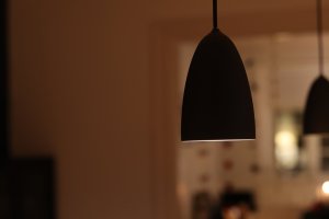

Can anyone please explain to me what is wrong. Took a series of pictures today with this little dog.
Every second picture I took in fast shooting mode and animal eye detection mode you can see white and purple dots when zooming in the picture!
1. picture you see the dots. 2. picture no dots...

My R6 is set up to shoot both RAW and JPEG.
I have seen the phenomenon in many of my pictures. Typically I have chosen series shots and with animal eye detection. Here the spots are seen in the same places and typically in every other picture in the series. I only discovered it yesterday. But by going back to a series I have shot of flying birds, the same phenomenon is seen. Very frustrating! I have not checked up the RAW files, but no editting, just straight put of the camera. I’ll check that later. I'll hand in my camera tomorrow for checking.

There is some pattern in the location of the dots.
Have you tried with different memory cards?
I have now tested with different memory cards. It's the same pattern. In single shot mode there are no problems. In all continiues modes, the dots appear in every other image ....
Another observation:
Pictures without dots file size JPEG 4,4 MB
Pictures with dots file size JPEG 7,7 MB
