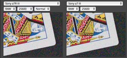

from 3200 ISO, you start to see more noise from the A7R III and it becomes more evident from 6400 ISO upwards.
Not at the same view size. Here they are at 25,600, RAW, same view size:
The noise is sharper (vs. A7 III) but so is the whole image. And there's not more of it. Whether you print as is for maximum sharpness or apply some NR, the A7r III image will come out on top.
To be clear: all currently shipping FF bodies are excellent at high ISO. There's not even 1 stop difference between the best and the worst. But if we nitpick we find that it's not the lower resolution bodies that come out on top.
