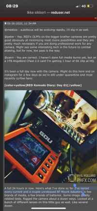

While talking to him, he suggested the Kipon adapters. I went to their website yesterday and came across this image:
So yeah, I'd say they're the guys to check it out. I'm pretty sure they have anFD to RF adapter that feels solid and reliable.
