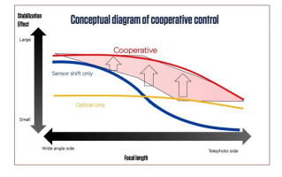

Uh oh! I see the R5C has no IBIS. Since I do a lot of bird shooting handheld with my RF zoom at 500mm, I need all the image stabilization I can get, so no IBIS in the R5C is a show-stopper for me, sadly. I wonder if the R5II will have both IBIS and no 30-minute limit.
IBIS is providing very little benefit at 500mm, if any. See how the blue line is pretty much at zero for telephoto?
If you'd cited stabilization for indoor static shots (e.g. architectural interiors in places where tripods are not allowed), that would make sense. But any stabilization you're getting at 500mm is from the lens.
Canon doesn't let you easily test that, since you can't deactivate lens IS and IBIS separately, turning off IS on the lens also turns off IBIS. But IIRC, you can set the camera to release the shutter with no lens attached and unlock the lens (i.e. give it a very slight turn as if you were removing it), and IBIS will remain active but lens IS won't (neither will AF, aperture setting, etc.). Or you can just believe Canon's viewpoint on the matter, pictured above.
One relevant data point – the RF 100-500L is rated for 5-stops of IS on the EOS R (which lacks IBIS) and 6-stops on the R5 with IBIS. That's the same as the RF 70-200mm, but I honestly don't know how Canon specifies IS performance. The standard states that it's up to the manufacturer, so that doesn't necessarily mean 6 stops at 500mm.
