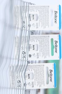

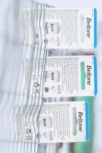

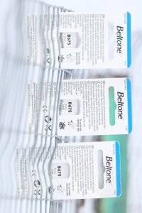

Thanks for this encouraging reply. As it happens today was somewhat sunny and +4C, so comfortable enough, so I set up the tripod and my targets on my stucco wire fence as illustrated here and ran through a series of shots. I used a distance of about 40 feet (this was 400 DO II X2 III). The targets were at the camera height and perpendicular and based on the wire dimensions, the top closest was 2" ahead, the bottom, furthest was 2" behind. Focused on the center/middle one. I have a fancier target but wanted to try this. It wasn't bright enough so ISO 1250 to keep the shutter at 1/1000. Spot focus and one-shot for all shots.
I think where I've gotten off track is judging the best focus to be somewhat midway when it's not as the three samples show. From all the shots my best value seems to be AFMA = 3 but get this, here is a chickadee taken when I was at +11. That's what has been driving me crazy.
Jack
Jack
Although it is hard to tell on such a small file, I think the feather detail on the bird's flank just over and just beneath the wing are in focus but the eye is not - going from +11 to about +3 may well address that.

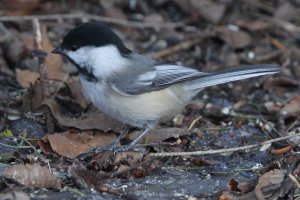

I AFMA my 7D2 with the 400DO out in the field by focussing on a bird (on a feeder at the time so relatively steady) and looking at the image on the camera screen. AFMA of about 5 made the difference between the eye pin sharp and the focus being on the side of the head.
But Mike, unless my fuzzy old brain is really in trouble, +11 should be producing a strong back focus (see AFMA10 shot) but I see earth in front of his feet in focus. This is not my birding mode but here I purposely used auto-selection for a comparison (3 squares on the wing area). Could it have more brains that spot focus??
Very off topic so I'll possibly post more photos to a new thread if necessary.
Jack
If you focused on the wing then focus is pretty OK at the AFMA setting you have. But again it depends on which part of the wing you focused on.
My point was more about how big an effect that AFMA has. My photos were taken at about 4meters (probably about the same as your picture of the chicakdee) and it seems that at those distance a seemingly large AFMA can have a relatively small effect on what is in focus. At distances of 20 or 30 metres AFMA will be less critical. I recall reading that AFMA at long distances may not be the best setting at shorter distances so I wonder if that is what you are seeing.

I had a target with a sloping scale, which was on a tripod to adjust height and angle. The camera was on a tripod and I used the camera level to insure that I was shooting perpendicular to the target which was square to the camera. There were a couple things that influenced my situation. One was needing to be outdoors in Alberta in February and another was using equal distance front/back rather than simply the sharpest image. There may have been other inconsistencies in spite of my best efforts as my hands were freezing not to mention .... :)
One thing I didn't realize is that even the 1DX2 doesn't focus that great with back light and due to temperatures I was shooting test shots out a south window with my birdie subjects rather poorly illuminated. I imagined that the camera would refocus on a transitory bird and well, it can't, in spite of fiddling with the settings. Furthermore, I was sometimes using the 400DO II X2 III @ F8 and outer focus points, which I didn't realize were not cross type. Steep learning curve for me at a poor time of the year!
Sometimes I do dumb things but for the most part the AFMA wasn't in that class. I'd done AFMA numerous times with my 6D but coincidentally always with the luxury of spring/summer/fall. ;)
And, I'm now enjoying the 1DX2 with good focus so the AFMA values I achieved at the end seem fine.
