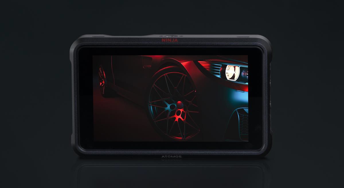

Melbourne, Australia – 28th April 2021 – Atomos is thrilled to announce that it is expanding the Ninja family, with two exciting new Ninja products and a major update for Ninja V!
Ninja V receives the option for H.265 codec upgrade, Ninja V+ – is built for Apple ProRes RAW 8K productions, and Ninja Stream – 4Kp60 HDR for a high-quality social distancing production environment.
The Ninja V receives H.265 (HEVC)
The original Ninja V, launched in 2018, remains the most popular Atomos product and receives the ability to add the H.265 (HEVC) codec. The 5” 1000nit 10-stop HDR monitor allows users to accurately monitor and record from either HDMI or SDI. Atomos continues to expand Apple ProRes RAW support on all partner cameras over HDMI and SDI. The Ninja V will continue to receive updates for cameras and additional functionality via AtomX modules whilst remaining at the price of $595.
