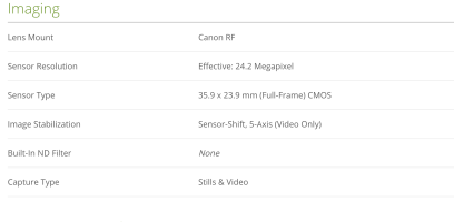

BH says it does. In video.I'm thinking that the R8 does not have IBIS
Upvote

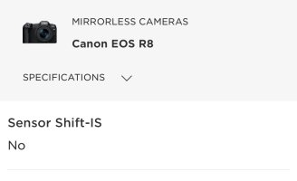

Canon says it doesn’t.BH says it does. In video.
Yes, it supposedly has "sensor-shift" stabilisation in video only. As opposed to digital stabilisation.BH says it does. In video.
I will obviously believe Canon more than BH. Let me check further...Canon says it doesn’t.
The online reviews say it doesn’t, e.g., PetaPixel, “The lack of image stabilization also means video shooters must carefully plan their shoots around either image-stabilized lenses or situations in which the camera can be locked down on a tripod or gimbal.”
Personally, I’d believe Canon. You can believe the spec list on a vendor website if you want.

Supposedly, according to who (besides one vendor website)?Yes, it supposedly has "sensor-shift" stabilisation in video only. As opposed to digital stabilisation.
That means no sensor-shift IS. Movie Digital IS uses a slightly cropped frame that ‘moves’ to compensate for camera motion.Canon says "Lens/Digital". Lens I understand. What is 'digital'? I think the plot thickens. There seems to be more to the story...
Exactly - hence my "It's possible that B&H have got their facts wrong, and the R8 *only* has digital stabilisation".Supposedly, according to who (besides one vendor website)?
I am sure that it says that but I am also sure it is wrong.Yes, it supposedly has "sensor-shift" stabilisation in video only. As opposed to digital stabilisation.
But according to dpreview, there is no IBIS for stills, which seems odd, only OIS.
This suggests to me that there is an IBIS unit in the R8, but that is is disabled in stills mode, presumably for product segmentation reasons.
